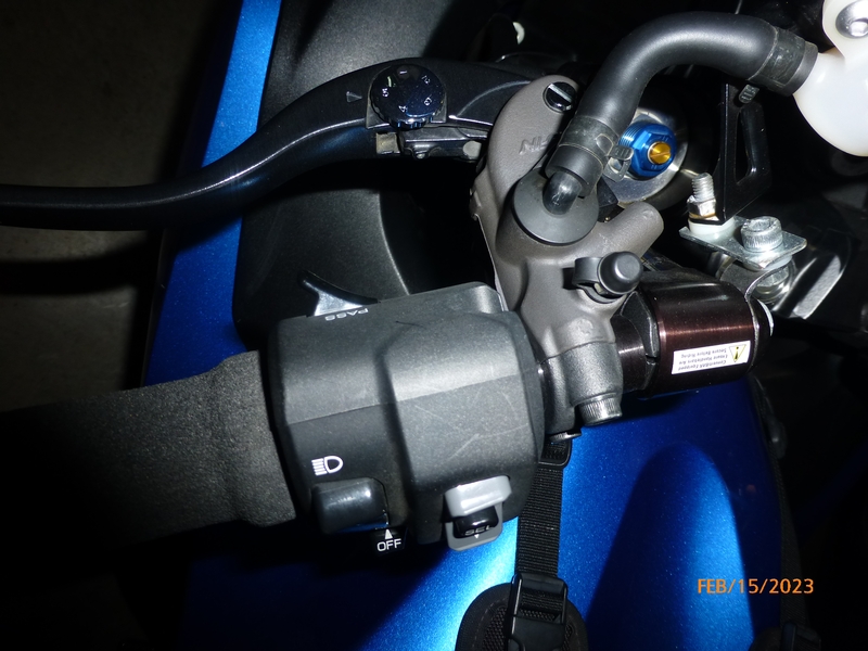

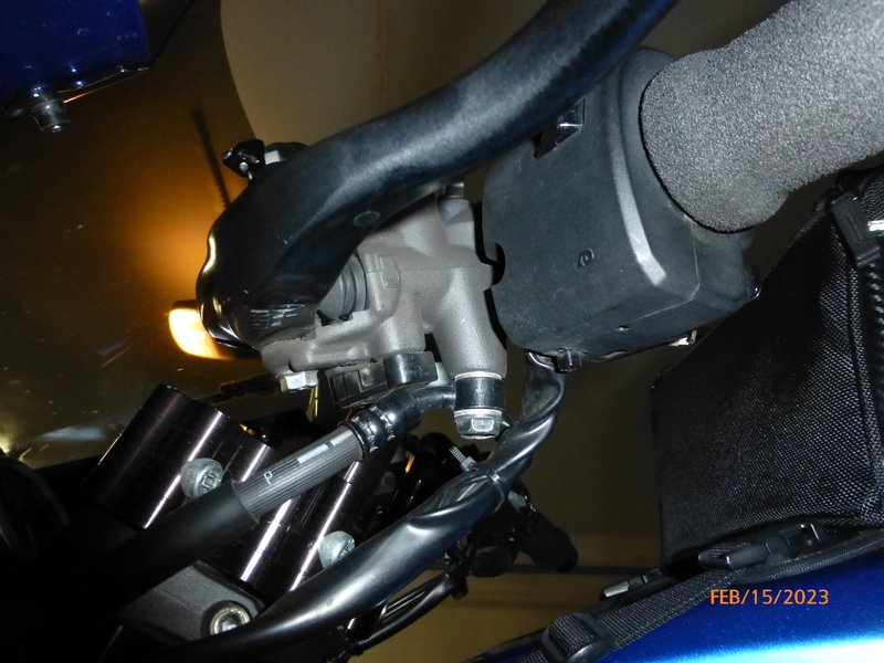

hi guys, for my 2019 zx14r, I had tried to upgrade the Nissin clutch mc to Brembo 16RCS mc. but I failed because the shape of the Brembo lever. The Brembo lever is too short. It hit the light switch assy when I hold it. I checked with our Brembo dealer. They had no solution on the issue. I had to give it up.

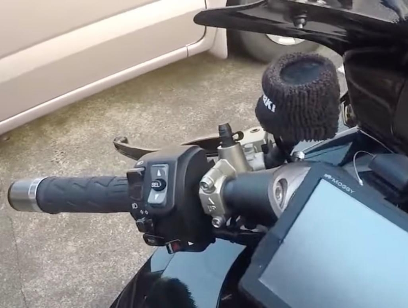

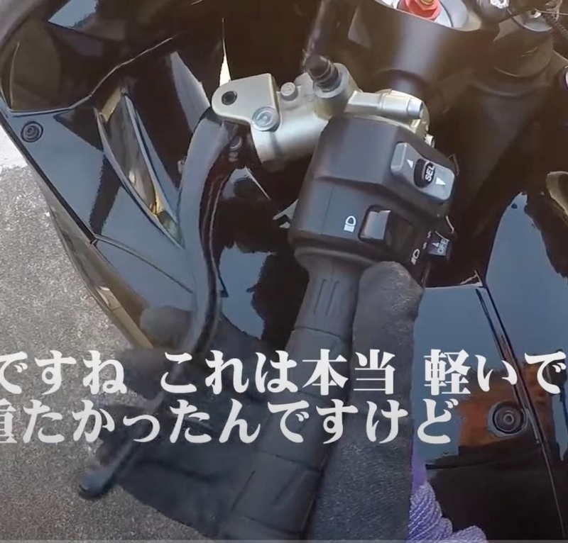

I found a video couple of days ago. A 2012 zx14r equipped a Brembo clutch mc. I can confirm the lever must be a kawa part. The mc assy should be from a H2R after I searched online.
It looks like there is only one modify I need to do. it's the clutch safety switch. I have compared them by photo of parts. I may need to make a connector of 14r's to plug in the h2r's. It should be ok.
The reason for changing the clutch mc is the lever make me feel very sticky when I hold/release the lever. I already lube it even grind the surface of lever. I can't improve it.
anyone done this before? Thank you for any posting.

Why change the OEM Clutch lever MC?
I know in 2012 (my Bike) the Brembo lever MC was not a factory item.
My MC has worked fine for 10+ years.

@doubleD,
The reason for changing the clutch mc is the lever makes me feel very sticky when I hold/release the lever. I already lube it and even grind the surface of the lever. I can't improve it.
Maybe I should say the lever is too heavy. Anyway, the Nissin one is not good for me.
