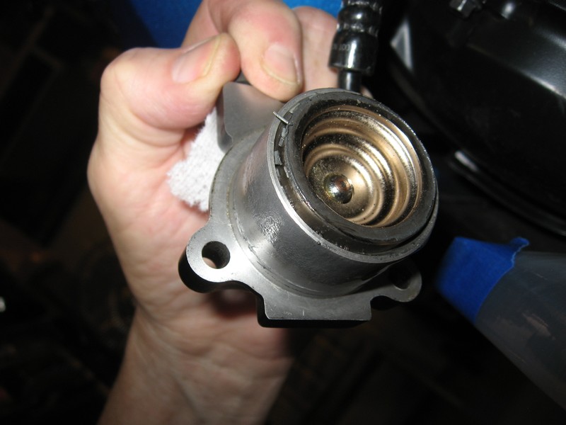

What Island said. Check the clutch slave cylinder closely for leaks or sweating. I had to replace mine at 19,000 miles.

Check for leaking Clutch slave Cylinder. My 2012 was leaking on the midpipe, right after my 12-month warranty expired. I got a new Clutch Slave cylinder.
In my case, I think the bore had itches resulting in poor sealig.
