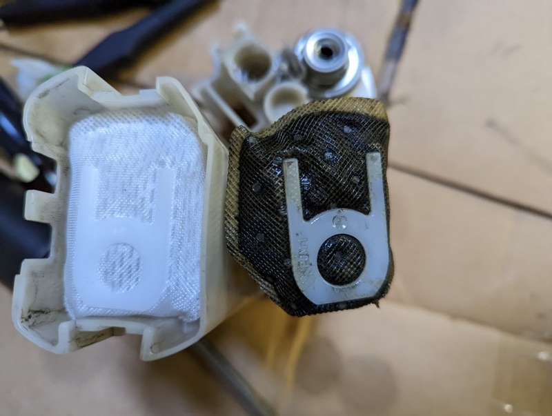

Well I removed gas tank pulled out the fuel pump and sure enough the pre filter was completely clogged! I don’t know how it even ran so I cleaned it as much as possible until I can order a new one and it runs like new now, just unbelievable how much gunk was on that filter!

There was no rust just a black goo looking stuff, I really wish I would have thought to take a picture, I was just so excited that I knew I just found the problem I didn’t even think about that. I have always used high octane since the bike was new and added the ethanol enzyme treatment to every tank so maybe that stuff doesn’t work. I know I’m going to try and use non ethanol gas from now on.

There's a pretty good You Tube video by 2wheelforfun that shows the whole process of changing the filter.
It also shows the Kawasaki filter number, 49019-0013.
I changed the filter in my 2012 ZX14R and it too was black and clogged.

on a recent road trip, filled up the fuel tank at a petrol station in the highlands, before starting a long downhill trek... when i got to the bottom, the engine was struggling whenever i twisted the throttle, and just died when stopped and idling...
waited for a while, tried to re-start and all went well, as if nothing had ever happened, but the issue would repeat after every long downhill ride and when the tank was less than half full... checked the fuel tank, found a partially clogged fuel pump filter, and petrol mixed with a fine black dust
i reckon the dirt came from that petrol station in the highlands, probably a filthy storage tank?

The FSM for early 14R/ZZR1400 states that the filter isn't replaceable and a blocked filter necessitates pump replacement! Yeah, right! It looks like the pump was changed for 2016-on bikes. I've no fuelling issues at the moment on my 2012 but I'm thinking about checking the filter after reading this thread. I'm guessing (hoping) the filter will be cleanable/changeable with maybe a bit of pump dismantling? Any ideas?

Video is well done and explains every step. Worked great!

Thanks for that! A very useful and £££ saving video. The price of a new pump assembly here in the UK is £525!! From 2016> the pump has a different part number but is EXACTLY the same price. The parts diagram for the later models shows an exploded diagram of what appears to be the same pump with a separate "filter kit" available for £64 which consists of filter and new seals/grommets. The same website lists the filter on it's own (not for the ZZR) for under £20 so I'll go with that.
