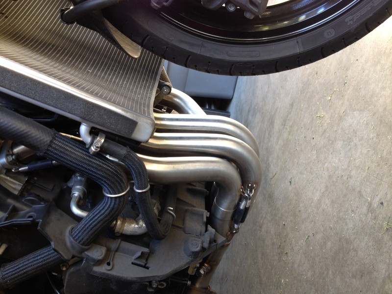

Goin from the stock header with my Muzzy slips (cut down to 15"), to the akrapovic header and the exact same slips, gained me about 4-5 horsepower on Priscilla. I think the Akrapovic header flows great, the bends are smooth and the welds are very nice. Just my 2c.

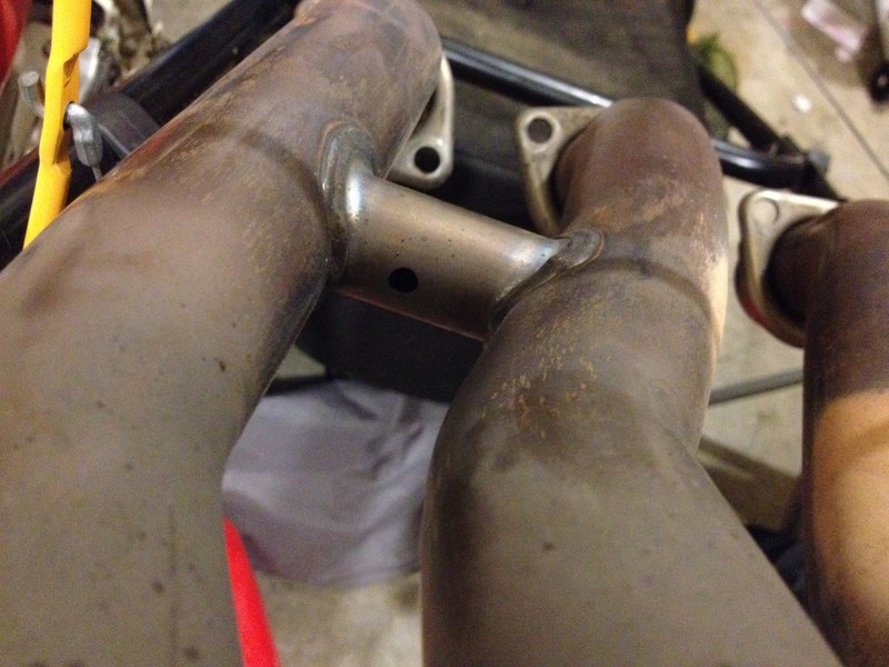

Oh yeah, the stock header does not have crossover tubes, if you look close, those are fake crossover tubes merely for structural support. You can tell this because they have a small hole in them. Crossover tubes that function, can't have holes. :)) the stock header is great for hangin on the wall next to the moose antlers.

Stock header...

Haha moose antlers...thanks for the input, the Akra headers look awesome. seems like better fit and finish than anything out there, Akrapovic quality.
CBlast, thanks for sharing. Was the 4-5HP just bolting them on or with fuel mapping?How much would you say the slip ons were worth? thanks...

She needed a very minor fueling tweek of less than 1.2% with the headers, with the slips alone, the midrange improved, once I installed the slips and mapped with the flash, the difference was probably 8-10hp. Now that she is set up the way I want, I wouldn't change a thing. Absolutely love the sound and the way this setup performs.
