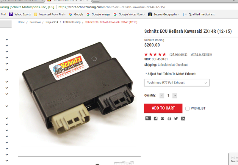

Well, when I plug in the Yosh full system in the website the price at the top for the flash says $300
So, I'm not sure what's going on.

Here's a screenshot of what I see:

I would order from a computer that says $200.

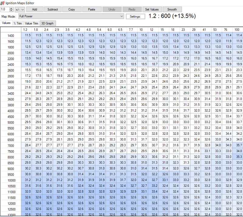

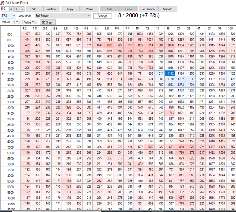

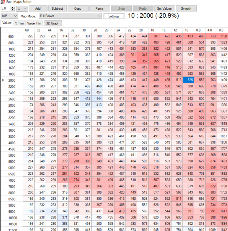

For those experts who may chime in, here are screenshots of IAP_TPS fueling and modified ignition table that I'm running. As far as drivability it seems more responsive but in regards to performance gains over stock parameters I'm not quite sure. If there are any gains they are minimal and the butt dyno isn't able discern the difference.
Here's the IAP_TPS tables where fueling was mostly removed on average 8-10% and the modified ignition table that I picked up from here in the forums.
One other observation after flashing this setup is that my idle dropped down to under 1K RPM, and at times it seems to want to die out. Once I give it a quick blip the idle rises back to 1,050 ROM. I assume this is fuel related?.?.
Also the bike runs cooler which I thought was odd, because I would've thought by pulling fuel and adding ignition would make the bike run warmer....adding fuel usually cools the engine, at least that's what I thought.

Probably the timing on that one. I played with an OEM race-ECU program just playing with entry numbers on the map. I'd enter a number and it would accept it or throw a red block; indicating it will not compute with said number. Too bad other aftermarkets programs don't install that. More or less, you're more throwing darts at it without having that handhold popup.
Those sort of numbers throwing is more a guess at it. There is something called a truthtable the processor calc's off of. Sure it will calc, but will send in the best number of the calc'ing thru the tables. And that number might not work in other words, but the table calls the calc, for 'best' number.
It's complex now, due to the layout of the chips. You more or less wire up gates that switch around hitting
'and/or/nor' gates laid out as the table is built to the wiring of the chip. Because of the 3rd wire hanging all alone, that switches to an and/or/nor gate in other words. You build the motherboard following how you wired up the 3rd leg to said hard part.
Eventually the 3rd leg is soldered to ground, and there is the complete loop for said chipset.

I sorted out the low idle issue by flashing back the stock IAP fuel map, and it's idling smooth as glass now. I'm going to run the updated flash and see how it performs over time.

Guys, does +4 degrees affect the minimum fuel requirement? ie 98 only?
