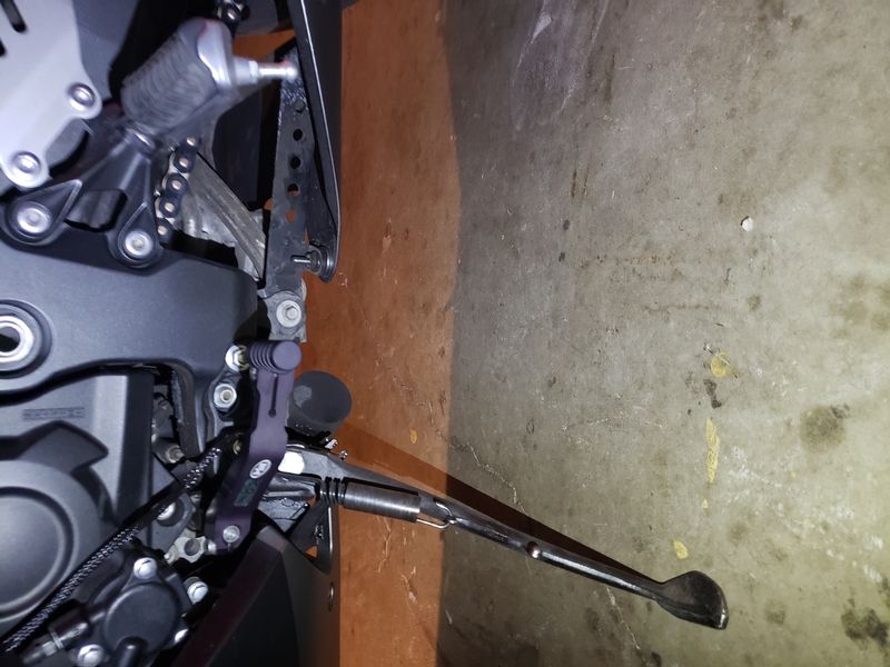

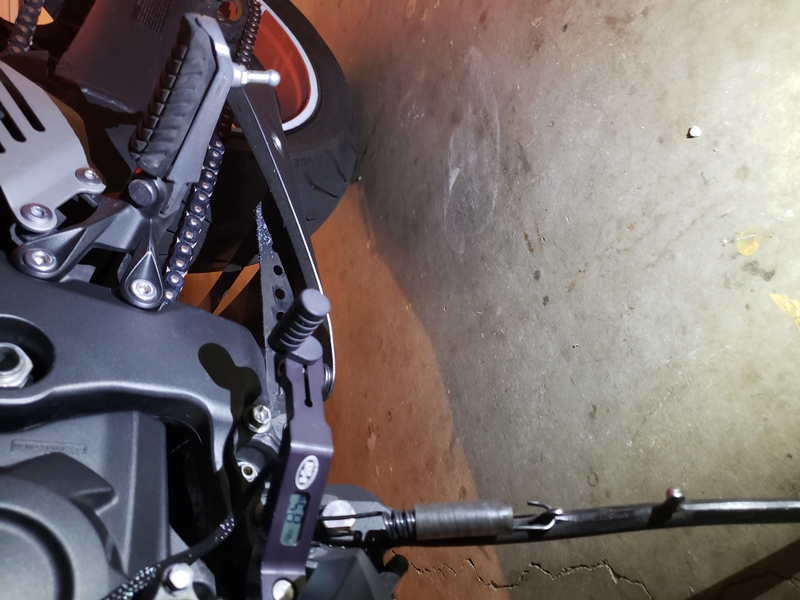

Hey guys...This is specifically for anybody who has a HM QUICKSHIFTER **Plus SS** with Lever ONLY!!!
I have not been able to get this thing to work appropriately almost 2 months in my posession now. Everything has been installed and double checked/constant emails to HMs wack customer service/support. Basically I have had to have the sensitivity settings at a max 100% to register any kind of shift.Its not smooth at all. I have the shifter on extension settings and kill times set for 68 ms. I just got an email from HM stating that I need adjust the levers position to a more horizontal/ level position and have the toe spigot 180 on top.. to get a more accurate reading. I still are not able to register any shifts lower than 100% sensitivity.This is highly frustrating and I'm seriously considering a refund and go with a much cheaper product because at almost $800 this is Ridiculous.If one of you guys have the lever , if you wouldn't mind sharing your settings and a pic of your lever setup I could use for reference I'd greatly appreciate it. I am using the stock rearsets. THANKS!

Yes I remember you saying so Rook. Dammit!.. I was wondering that very thing and the cold part about it is this is suppose to be a brand new replacement lever that was suppose to correct the first lever's spline fitment issue. So I talked to them(HM support) via email again, They recommended me trying to actually run the bike with the changes to lever position and toes spigot and see how it performs. I was under the impression that you can also do pre tests simply trying to engage a shift by looking at the LCD and lifting or pulling the lever,possibly getting the shift icon to register. They told me I have to run the bike to test.thats not totally accurate. Hmmmmm?

Exactly, lol I too was initially going to put the bike on the rear stand but was told that was extremely dangerous even though I see a lot of people doing it... and having our bikes on the stand run an increased risk so I learned about option B which was the calibration through shifting the lever by hand getting a registered shift through LCD. I guess I’ll just have to take the bike out and literally do runs and see if a can get a good medium. So far I am highly unimpressed.im seriously wondering is a Woolich/ Heal Tech/ or Bazazz unit as difficult as this quickshifter has been?
