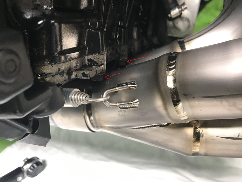

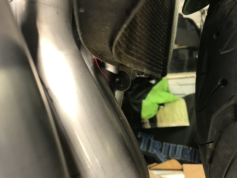

I'm trying to get this CT System fitted and its turning into a nightmare. 2012 Gen2
One of the Header Pipes hits the back of the Radiator, 2 of the Sump Bolts hit the Headers down where they meet the Collector.
I've spent hours now trying to get this System to fit. I'm out of ideas.

Loosen everything.Remove springs.Start at header.Check fitment at exhaust port seals.All the way in?Don't fully tighten the bolts in case you need to wiggle something.It looks like in your top pic the header needs to move back as much as possible.It doesn't seem lined up somehow.Maybe check it and if tight,loosen then make sure the seals are even and flat in the block..you'll probably need to give em a good shoving)(lol)if they feel stuck or something.All other pipe connections loose?
I've had at least 2 brock's systems.On the 14r,2012,2013.They NEVER just slide right in.You are using a bit of lube on those?
Scenario 2...your radiator has over time shifted back a few cm.
