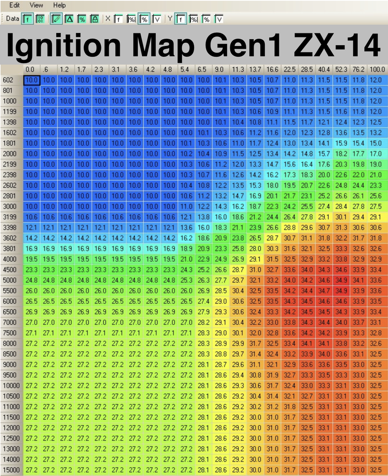

The timing is retarded in gears 1, 2, 3, and 4. Lower the gear, the higher the rpm before the retard is removed. The retarded ignition makes less power. This is another safety backup for people who can't control the throttle. It might be more complex than just advancing 4 degrees. There is a timing map for each gear and every cell has a different number in it so the correction would probably be different for every cell as well. I do not know how nitpicky anyone gets on tuning timing. The tuners who have seen the ECU tables (as I understand it, this requires more than Woolich software but Ivan and Guhl know the timing) know the exact numbers. Romans gave me roundabout numbers and +4 for the lower rpm range is about what he told me. It tapers off as the rpm increases so your doing +3, +2, +1 and finally no correction or even retarding a little for thetop end which I think Romans felt was timed too aggressively. This is all Gen1 info--the Gen2 is a bit different concerning timing.
Your flash will achieve the same or similar results as using a TRE. It's a good thing, you definitely want it for sport riding or having max rider control of the bike's power. I know ironheaad mike installed a TRE on his Gen2 so you might want to ask him about the change it made.
If you run nitrous or turbo, you will want to get that timing reflashed and/or control with your own ignition controller.

Yeah that is cool that it's possible to adjust timing/gear with a flash. Fueling works the same way, there's a separate map for each gear. A TRE prevents the ECU from recognizing any gear changes and keeps the mapping for timing, flies and fueling on N or 6 which have no restrictions.
It's always been possible to adjust fueling and timing / gear with a PC5 and Ignition Module but few people wanted to mess with all of that. The timing aspect is kind of obscure. Nobody knows the exact timing corrections for any gear except for Ivan and Guhl. The timing curve I described is safe and improves power but you have very small changes in timing / rpm and TP just as you do with fueling. We don't know for sure what those exact numbers are. Here is a Gen1 timing map. As I understand it, the ECU uses this same map for every gear but adjusts the timing for gears 1 through 4 differently for each of those gears.
Here's more info on that if you care to read.
Anyway, if it's optimum performance you're after, it's doubtful there is much if any benefit to having mapping/gear. The timing, flies and fueling that create the most power for 1st gear are the same for every other gear. Using a TRE to lock into a gear map that has no timing restriction (5, 6 or N) and then tuning fueling optimizes power for every gear equally. I suspect most flashes achieve the same effect by unifying the gear mapping for fueling. You still have 6 fuel maps but they are duplicates. I also suspect most flashes use a timing curve such as I described in my previous post. They don't know the exact number of degrees the timing is retarded or exactly what corrections the ECU makes/gear so they go by a generally accepted pattern along with what they can determine by dyno tuning. Romans seemed to feel the basic timing curve I alluded to was good for all gears. He was not into mapping/gear--at least not with a PC5 and Ignition Module...maybe he did it with his flash though--IDK.
